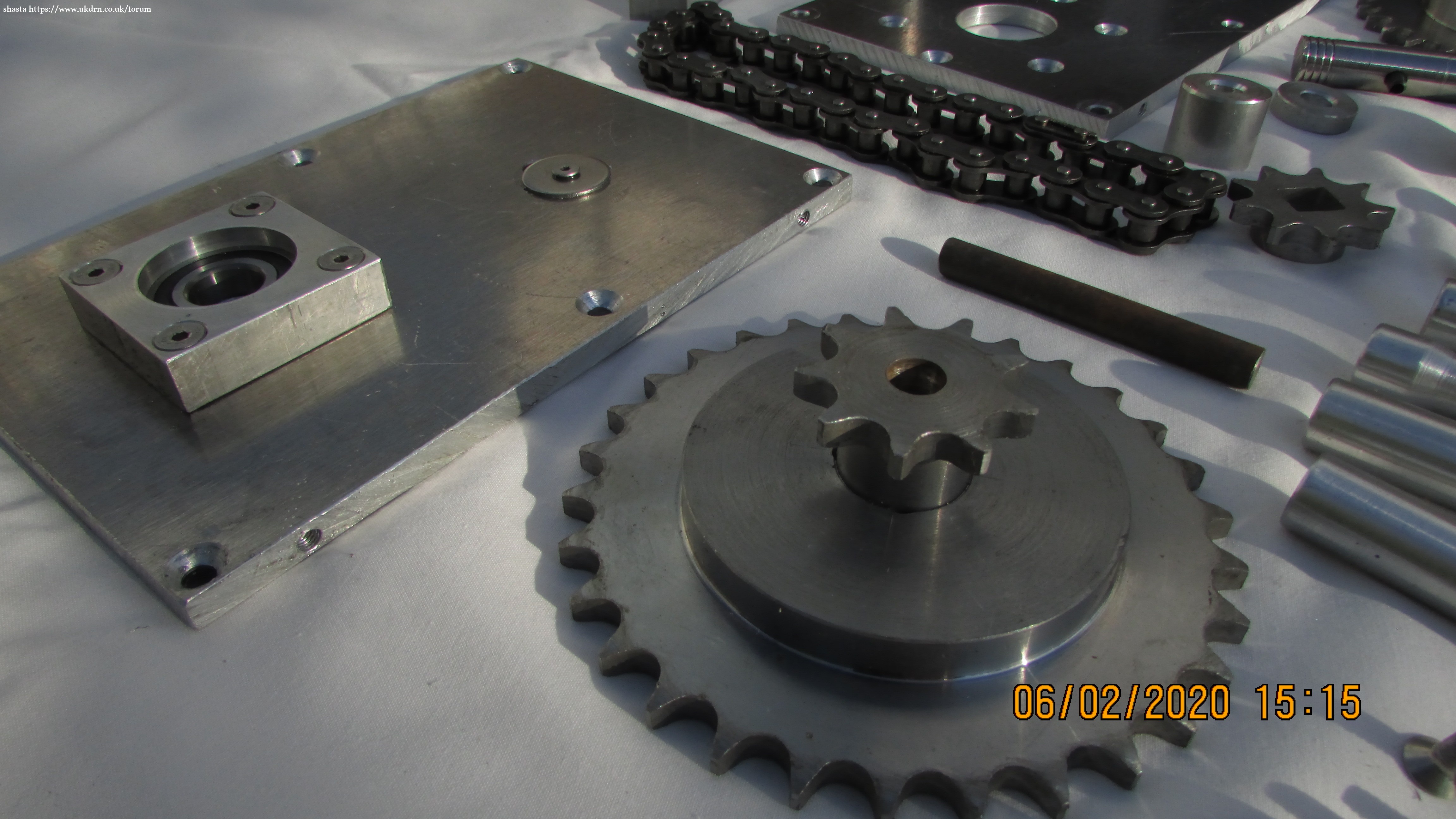

Photos show the construction from the blank sprockets to the finished item. Sprockets and bearings from Simply Bearings, ali plate from Metal Supermarkets is Southampton all other bits out of scrap box.
Will be fitting unit to the starter motor and then it's fingers crossed again to see if it works to plan!

 #40168  by shasta
The gearbox is finally finished and fitted to the starter motor. As you are aware the motor had no problem spinning the motors over with the plugs out, but with them in it was another no-no. The photos show the finished article and the two video clips show what happened.
