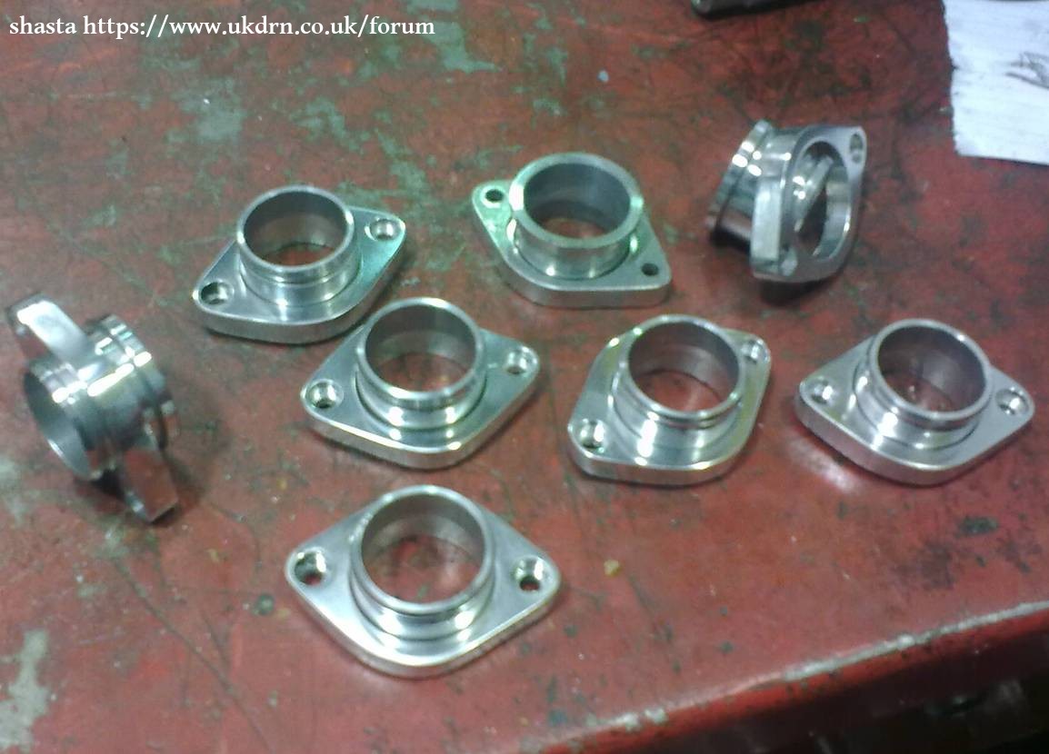

The original bike first appeared with Amal carbs and as the bike was improved it finally ran with Hilbourn fuel injection running on Nitro. Experience and finances meant I would be using carburettors running on petrol ,but using Kawasaki carbs were out of the question due to their cost; anything related to Z1s or Z1000s commands high prices these days.
The obvious choice were the carbs fitted to the Suzuki GSF1200 Bandit model as these have been around for years so there is a good supply of them on the market. Having obtained two sets and offering them up to the Kawasaki cylinder head showed up a potential problem. The air inlet spacing of the Bandit cylinder head is different to that of the Kawasaki Z900 head and the Suzuki rubber inlet stubs have a different bolt spacing so can't be used either. Trying to fit the Suzuki carbs to the Kawasaki inlet rubbers didn't work either as the diameter of the Suzuki carbs is too big to fit.
The difference in spacing is about 5 mm and by luck it was found that the inlet rubbers used on the Kawasaki GPz600R have an offset of 5mm and are the same size as the Suzuki rubbers although are a push-on design and not bolted on, so all that was needed were some inlet stubs and I'd be in business.
The photos below show the stages in the production of the stubs ending with the carbs fitting the Kawasaki engines perfectly.
Difference in carburettor spacing
Inlet stub material
Inlet stub material
Tube turned to accept inlet rubbers
Stubs progressing
Stubs progressing
Completed stubs after cutting and filing
Finished inlet stubs
Carburettors fitted to engines

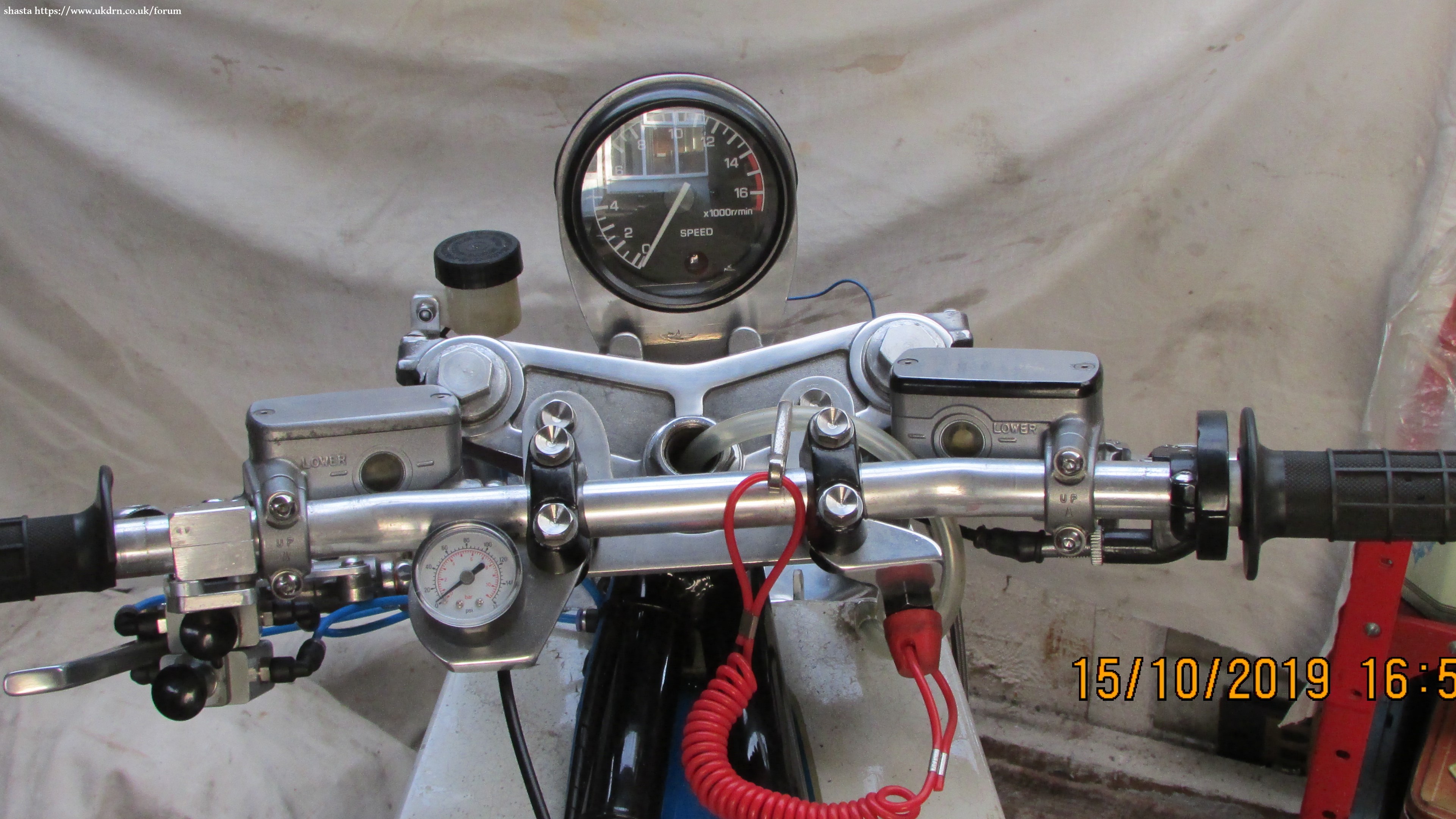

When at the Pod back in July, we took the chance to see if the monkey bike was capable of towing the double any distance. It did, but whilst in the riding position it became apparent that there was a slight design fault..namely my thumb couldn't reach the shift buttons or rear brake thumb lever..Doh!!!
Whilst thinking through how this could be overcome, there were several areas where weight could be saved and improvements made. The original fork yokes and steering stem were replaced by an aluminium pair from a Honda CBR400 with much thinner stem, taper roller head bearings fitted, the handlebars were moved back 2 inches and down by an inch, new bracket moved the shift buttons under the bars, a smaller brake reservoir was fitted, smaller rev counter bracket made, towing hitch fitted, titanium fork clamp bolts used and new light-weight handle bar clamps used.
Photos show before and after layouts with the first two showing the state of the bike 9 years ago before a start was made!!
Old yokes 9 years ago
old layout.jpg (1.24 MiB) Viewed 28605 times
Front end before rebuild
old bars.jpg (1.24 MiB) Viewed 28605 times
Old layout with shift buttons on top of bars
Old control layout
Old control layout
old layout shift buttons.jpg (1.71 MiB) Viewed 28605 times
New yokes and towing hitch
IMG_0015 (2).JPG (1.39 MiB) Viewed 28605 times
Shift buttons and brake lever under the bars
New control layout
New control layout
IMG_0016 (2).JPG (1.3 MiB) Viewed 28605 times
