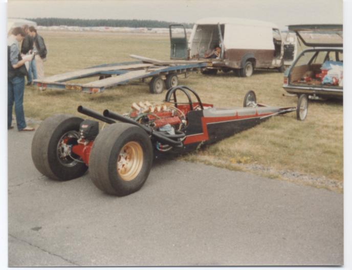

 #8728  by fester
I remember that car ,im sure it was light blue with a yellow cross,i also bought a rear engined dragster in 1984ish which originally ran injected hemi in svensk ,it was just a roller the guys that bought it said they were going to put a jag engine in it ,as i waived it down the road with 400 quid in my pocket,i thought to my self,,never see that one again, :D it must be in someones garage :shock: :shock:

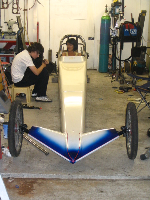

I like the look of the early rear engined cars [ mostly because of the Garlits cars from 1971-1975 ]. Most are gone or recycled into more modern stuff. Loads of people are building slingshots at present , and in the states, restorers are cottoning on to the early REDs as they are a big part of the history of Drag Racing.
I have just finished putting a new 7.50 cds steel saftey cell into just such a car. The old Richard Jarman 205" wheelbase cosworth V6 car that was run in the early eighties [ You probably raced agauinst it Dave? ]. It has Priddle bodywork and if it wasnt for that I wouldnt have bothered.I added 2" to the wheelbase behind the cell so a SBC/shorty glide combo would fit. I was going to sell the car but am in two minds to run my injected nitro Small block that I was to put into a digger.... hmmmm. Here is a pickie taken 2 days ago, just after I finished welding the chassis.

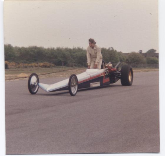

Lookin' good jon, here's a couple of snaps of it in it's hayday.........

Very nice indeed Mr. Mental, and a belated Happy Birthday for last week :D

Thanks for the pics Nick
My original intention was to keep the Westminster rear end with the split rim wheels, but have now decided to put a 9" Ford in there to make sure it could handle the power to run 7.50s or quicker. When we tried to get the slicks off , we bent the rims because they had sat on there for 20 plus years....ended up binning them. The westminster rear axle which has a machined spool and not welded gears, which is the norm, will be put aside for a nostalgia digger project in the future. The body on this car is very nice, and is very 1973, without being offensive to Richard or Dennis as I believe it was built early eighties.
As an aside, what is the quickest and fastest run with a C series axle.....this car ran 8.60ish @ 160ish.
